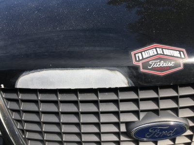

The tailgate and hood panels are made of aluminum. They do not rust (ferrous metals...), but rather corrode due to Ford’s very poor preparation and painting of the panels.
There is another thread on this forum (many, many pages long) regarding the corrosion.
Ford has known about this problem for many years and chose not to identify and fix the manufacturing process defect that has caused corrosion for so many customers.
I ordered and bought a new 2015 Ford Expedition Limited 4x4. The hatch began corroding before the base warranty expired. It is one reason that I will never buy another Ford product with aluminum panels.
