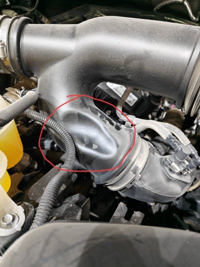

Is this air intake y pipe dent comes with the car?
nobody
Mar 12, 2023
22
Saudi Arabia
I got the car imported, 2022 stealth max, i just seen this and i don't know if it originally comes like this or not, if not then what possibly did this?

i have a 19 stealth and my y-pipe is not dented in like that.

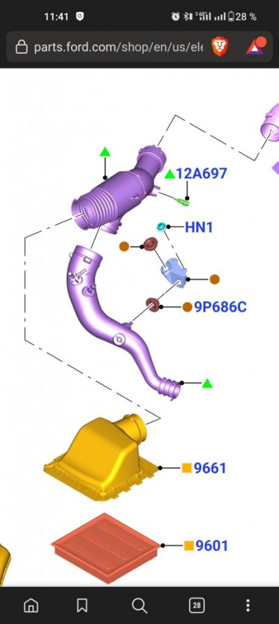

I tried to find the exact part number but i don't think i have the skills.
Is it 9c623?

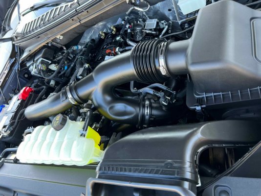

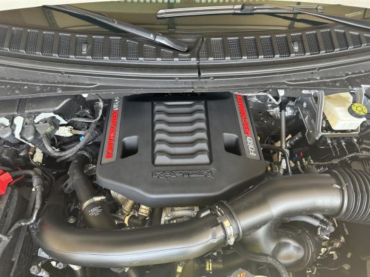

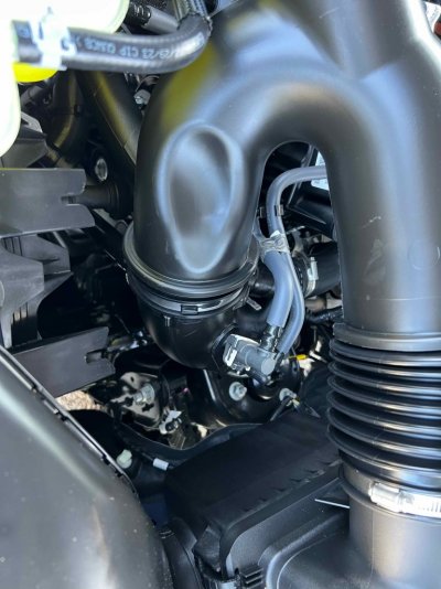

This is on my 2023 Max, King Ranch. It's OEM.

It is normal, my 22 has it as well. When I first saw it I went on an F150 forum and it appears there is an additional coolant tank there for the power boost engine. The dent is so the tank fits there.
