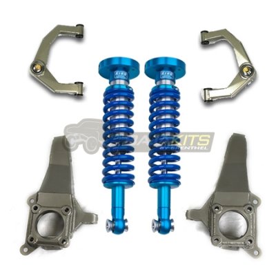

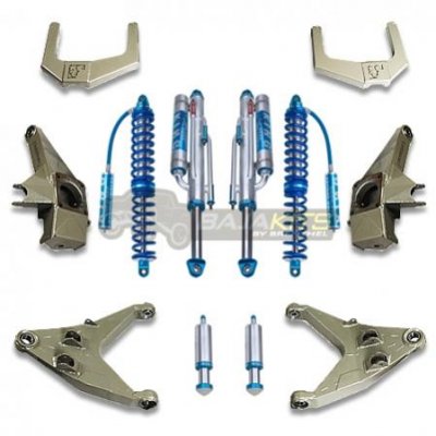

These are the kits that carry over to 3rd gen expy 2wd. first is 3K second kit is a race ready kit 7K.....

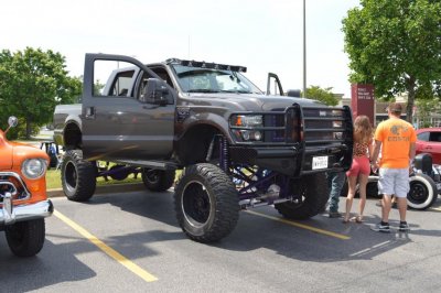

Its an 07 Navigator nothing but stock form, point is wifey wants an EL Navi or EL Expy and this ones gonna be mine to mess with. No air suspension to mess with and no 4wd on it either. I am planning on doing a lot to it. Meaning removing all the Lincoln stuff like the rear gate and swapping the steerin wheel out and badging and effectively converting it to a Raptor lookin rig and capable of backing its looks. My daily is this 08 F250. Fabrication is not new to me, the 250 has been 4 linked and coilovered up front and rides like a dream.

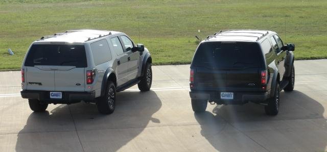

Fella named Tim Husky just north of Oklahoma City has been building Raptor-based 7 passenger SUV's (with Ford & Excursion parts) for a few years now. Like all of his conversions, they look 100% factory. Stretched Super Duty's and "new" Excursions are his specialty, but he's churned out plenty of these Raptor SUV's to those who can afford em. Building your own is definitely possible.
Ford Raptor SUV Conversion

Yeah I have s3en those 1 the price is insane!!! 2 Im really not digging the whole excursion clip to the back... make more sense to clip an expy EL rear??? Well i been trying to get a hold of someone at fiberwerx to see if they can graft the rear fender area of the expy to the 04 raptor oem kit they have.... if not i will have to find a good body shop to blend the door jams in!

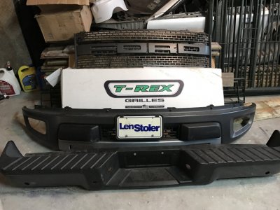

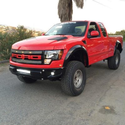

UPDATE!!! I want everyone to know that this project has not been abandoned but is still continuing. I was deployed about 8 months ago earlier than expected and just got back. Wanted to share some information. I have been in contact with Mcneil Racing Fiberglass and they have a 97 F150 OEM raptor kit that guess what.... also bolts on to our EXPY'S!!!! Price is $2000 for full front kit. Still need to source an OEM Raptor grille though and headlights which I already have! Oh and also it will be going on an 07 EL Black Limited That I recently purchased for my wife. Still have the Navigator also... still messing with that one. I see good things in our future with these kits fellas. Here are some pics on it installed on a 97 extended cab and crew cab F150. Check out the page on the site here https://www.mcneilracinginc.com/pro...-to-raptor-conversion-kit?variant=19847257671

yeah it bolts up but they did mention that the light brackets are the hard part to get the raptor headlights to line up properly but once done as you can see looks awesome. I have seen many 97 model f150's with expy clips so naturally any kit for the 97 f150 fits the expy. The door body gap is the same only cladding changed through years. Can not wait to get the clip and get it together.
