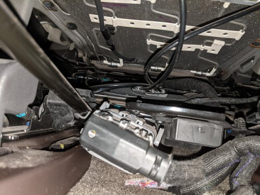

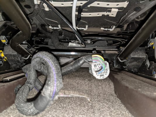

That is what I thought as well, but the service center says it's a seat frame issue.
I am going to bring to another ford service center on Monday to have them confirm.
One strange thing, the wire harness under the broken seat looks different than the harness under the driver side second row seat that works. I would think they should look identical?
Here is the non-working second row passenger side:
Here is the working second row driver side:

Just a quick thought. A house door with two door knobs would require you to turn them both at once to open the door. Since you don’t have to use the manual and electric latches at once, then most likely the electric and manual latches are the same latch. It just requires a different way to actuate each. I think there is most likely something worn out or broken on the electric actuator.
I’ll try to look at mine later to confirm this.
wakeboarder
Nov 16, 2019
811
468
Fort Lauderdale, FL
After a brief look at mine, I noticed that both the manual and electric actuation are both done via a cable. The end of the cable is circled in red below. There is one on each latch. You said it worked via the manual actuation. I find it highly unlikely that a frame issue would cause it not to work, but still allow the manual version to work. I would think it is most likely a defective actuator or some sort of mis-adjustment.
If you tilt the seat forward, you can manually close the latches and see if the open via the electric pushbutton. Just be sure they are open before you try to slide the seat back.
