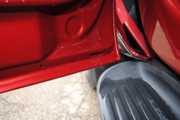

This is a picture of an F150 but check to see if the drains at the bottom of the door are clogged. On all cars and trucks, a decent amount of water gets inside a door usually past the lower window seal since it’s not super tight for the glass to move. They all have drains to let it out the bottom.

As shown above, pull out the plastic drain hole covers, which get clogged resulting in a door full of water, and just leave them out.
When the water drains, you may have some “gunk” clog the hole.
You can use the non-clasp end of a sturdy plastic zip tie to dislodge the gun, and the plastic tie will not scratch the paint.
