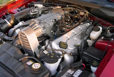

Damn! I thought we might see a Mad Max Interceptor addition.How cool would that be? Let us know if she looks like this under the bonnet??? 13A3887A-0520-46D6-88ED-D4ECF33FB8CC.jpeg
