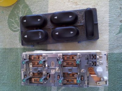

Some of them are really easy like the doors are already leds so they just swap out but things like the climate control are tough. The climate control only has 2 incandescent bulbs in it which works fine but leds are directional so I ended up wiring 4 leds in series from each contact to make it look good.

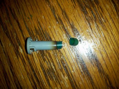

This is what I started with. They were aleady LED so the resistors are there too. All I did was replace the LEDs with blue ones and they work great. Now on my 2000 expy all the original bulbs had a green silicone sleeve over the bulb to look green. I tested them all with the sleeves off to make sure that the buttons themselves didn't have an overlay color which they didn't. The only one that did was the climate control and it was a plastic overlay that was just removable, so I did. I don't know for sure on the 2nd Gen. They are really easy to pull out and find out. Here are more pics of the process.
