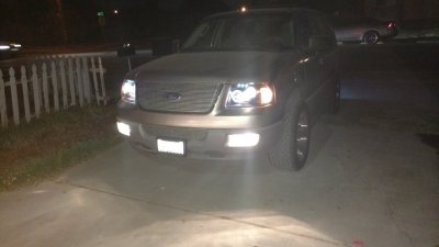

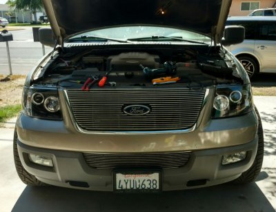

I changed out my puddle lights and plate lights to LED as well as my brake turn signal rear lights as well. Very happy with them. Also changed out my headlight assemblies on my 03 Expedition. I have attached a photo of the front.
Kingfamilyexpy
Mar 27, 2017
39
Tn
Love the halos what grill did you get and how much was it i was lookong for one before but black with the emblem place in the middle

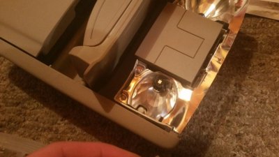

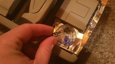

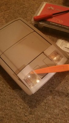

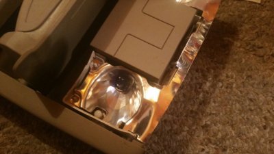

3rd gen? Yeah
Just will need a plastic trim prybar to safely open up the interior lights.
2017-06-07 22.25.25.jpg 2017-06-07 22.25.46.jpg 2017-06-07 22.26.21.jpg 2017-06-07 22.26.47.jpg 2017-06-07 22.27.05.jpg
And a push fastener puller and a replacement pair of fasteners for the rear license plate
PS there is NO need to yank out any modules from the car, I just had a spare overhead thingie laying around in the garage after an interior swap and used it to demonstrate. Normally just pop off the plastic button/lens thing and swap it right on the ceiling
