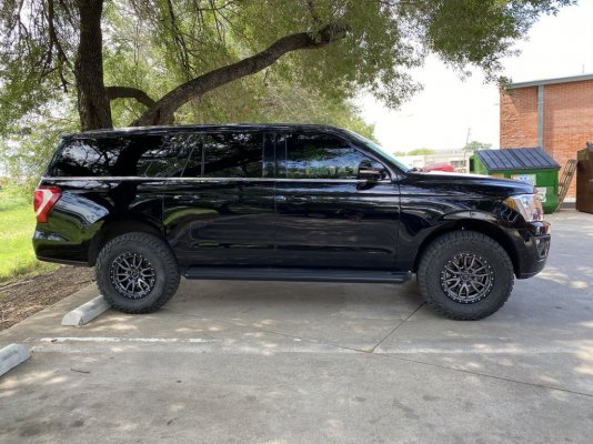

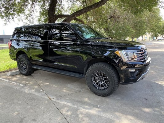

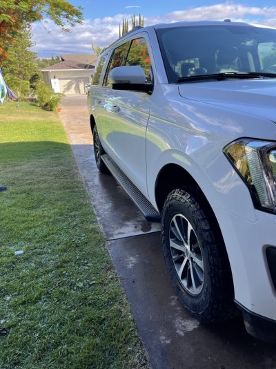

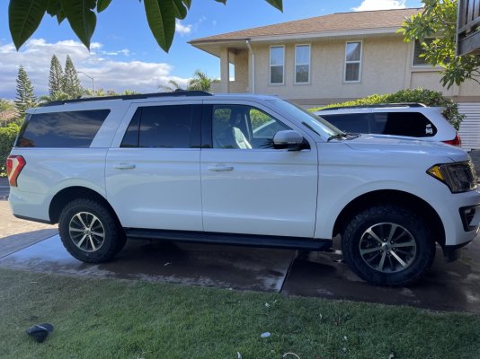

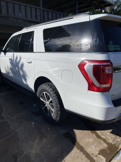

2020 Ford Expedition XLT FX4
Lift : Bilstein 5100 F150 struts/5100 Expedition rear shocks (2 inches of lift all around--for now)
Tires :Nitto Terra Grapplers 295/70-18 (34.3 inch tall 11.7 wide) and it does fit in spare well deflated
Rims: Factory FX4, .25 inch spacers for increased offset (for now)
Does it poke? No
Does it rub? Yup, fronts during normal driving and rear has almost no clearance. Have not fully flexed it yet but control arms will touch front springs during full droop.

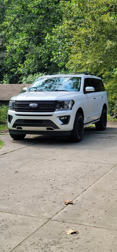

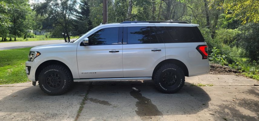

AwesomeFinally got the Icon Stage 2 and new wheel/tire combo installed. Will take better pics when I finish the roof rack.
Looks awesome. Any issues with running? And What size tires/wheels?Finally got the Icon Stage 2 and new wheel/tire combo installed. Will take better pics when I finish the roof rack.

Wheels; 18x9 +20mmLooks awesome. Any issues with running? And What size tires/wheels?
