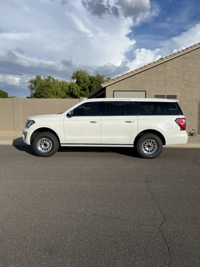

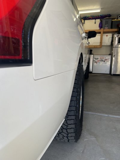

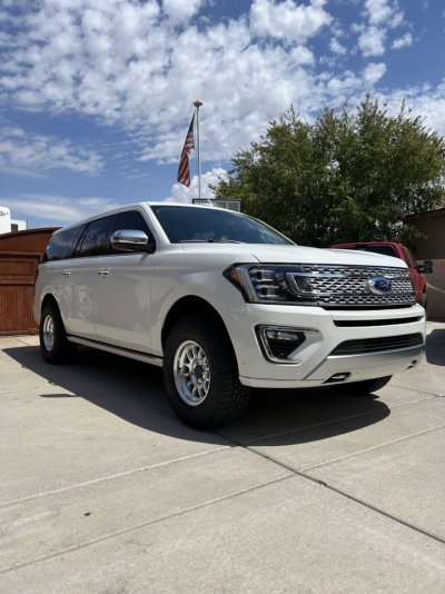

Finally got around to finish my Expy!
ReadyLift 3in front. I left the rear stock. I prefer a slight squat. 1in lower in rear to be exact.
Falken tires 285/70r17. No cutting, No trimming. I had to move the auto step about 1/2 back.
Raceline Rims 17x8.5 w/ 0 Offset (4.75" Backspace)
***UPDATE***
I added a 1in rough country spacer in the rear. See last pic.

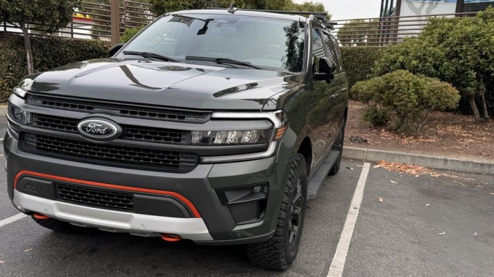

It is Timberline spec. I’m very happy with the wheels!

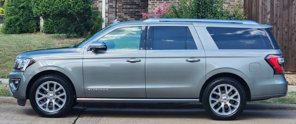

Not lifted but brand new larger A/T tires on stock wheels. 285/50r22. Took it for car wash, and of course they put a shine on the tires. A/T tires... Oh well, they still look good IMO.

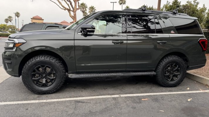

View attachment 77562View attachment 77563View attachment 77564295/70 R18 Toyo Rt Trail on stock Timberline rims and suspension. Didn't have to trim or move anything. Haven't noted any rubbing with normal driving. Thank you to earlier posters with their setups.

Looks really nice! How much noisier are these RT compared to the stock all-terrains? Keeping an eye out for the eventual replacements when my Timberline needs new shoes....
I didnt spend too much time with the stock tires but have 12k miles on the toyos now and tire noise is not an issue at all.

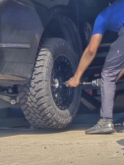

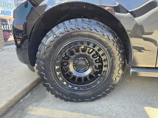

I know not an Expedition. But here is our Gator with KMC IMS wheels and Toyo rubber.
Stock height.
KMC IMS 18X9 18MM
Toyo MT 285 65 18

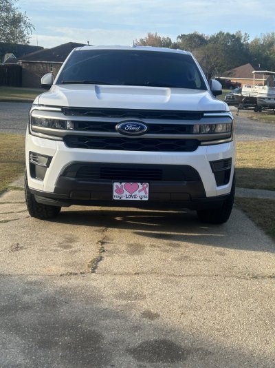

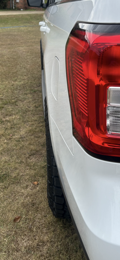

5’1 wife n small kids don’t like jumping or being tossed into my truck so she didn’t want her vehicle to be tall.
No lift however, the 285/70r18 sidewall lifted it slightly.
Wheels and tires were purchased well before the vehicle based on info from this thread so she says thanks.

Those wheels look good on the truck. I can sympathize though, my FIL lives with us and rides with us and is handicapped and already has a hard time with the height. I'd lift it otherwise.

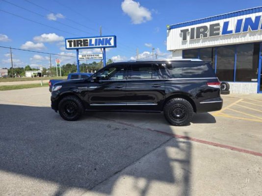

We just purchased a 2024 Expedition Max Stealth package and went to do the same setup this dealership has done. I called and they said it was just a spacer to level. Anyone else running this tire size setup and what would you recommend to achieve this setup? I’m new to the forum and thank you for your help and advice.
