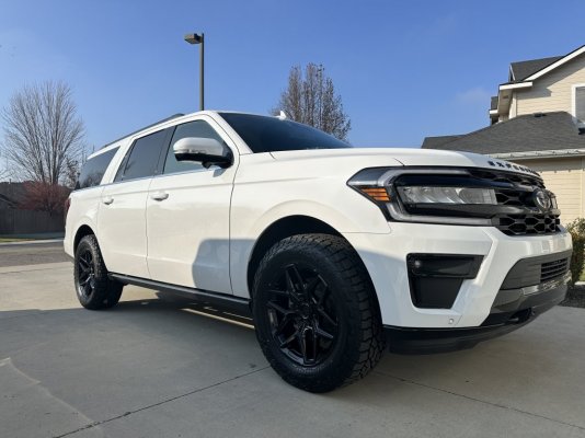

IView attachment 71351View attachment 71352I I just traded in my stock 22" wheels and tires (which in my experience were minimally capable in snow), for Black Rhino 22's and some tires with more meat on them. I wanted more capability and slightly more aggressive look without going for the full off road look. Ultimately i decided against suspension mods at this time. This expo will see plenty snow, but nothing off the road. Very happy with the outcome. NO noticeable difference in ride or tire noise, no rubbing. On 22's I believe this is as large as you can go without mods to suspension.
Specs:
22" Black Rhino Kunene 9.5 30 (i think)
Toyo AT3 305/45/22
I like this setup where where they from if u don't mind my ask Im trying to locate in Canada but hard to find stock?

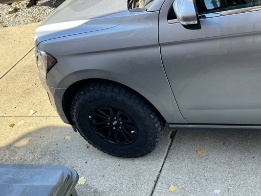

I have had zero issues with the Recon Grappler 295-70-18 on the stock Timberline wheels. It fits the body lines well. I have 35x12.5x17 on my Raptor but when fitting them on the Timberline the clearance was tight so I went with the 295'sExpy with Nittos.jpg
