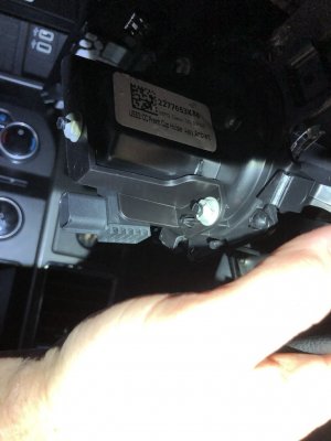

Update and possible reason for my liftgate issue.
1. I forgot to mention that we have the automatic lift gate option on our XLT.
2. My wife leaned on a cup in the cup holder and broke the bottom of the cup holder more than a week ago so there is a hole now and you can see down into the middle console. Yesterday, I removed the top portion of the console so I could look to fix the cup holder. There was a plug connected to the cup holder which I thought was the cup holder ambient lighting. The sticker near what I unplugged says U553 CC Front Cup Holder Assy Ambient 2277653X8B. Attached a picture of the female end of the plug. It wasn’t Ambient lighting. My wife went to start the vehicle after my original post above and the Expy said “no key fob” or something. I tried the backup key fob but it did the same thing. I remembered that wire that I left unplugged, and when I plugged it back in, the car started right up. I’m not for sure, but my issue could have been related to whatever I unplugged.

The left front cup holder contains the slot for programming a new key fob. My understanding from another post is that in the event of a dead key fob, the dead key fob can be inserted into the slot and the vehicle will still start. It may also be the receiver for the keyless start system.
