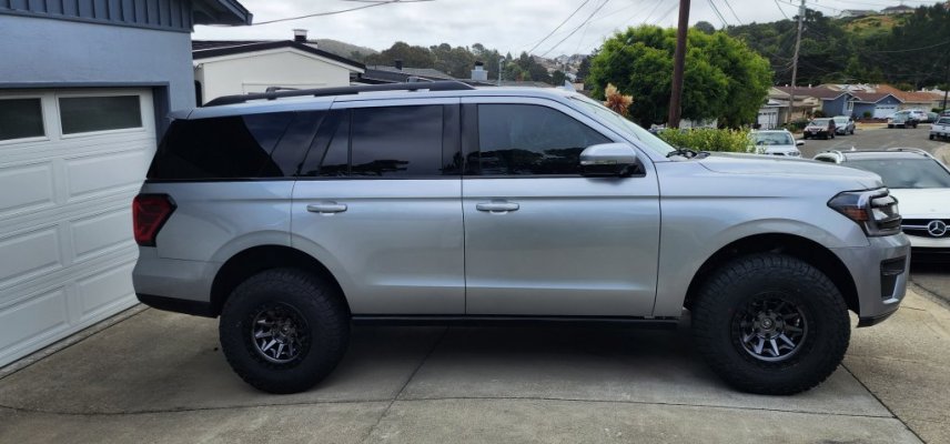

2019 Stealth with CCD. Ready Lift 3/2- but didn't quite get a 3" lift in the front as advertised. Wheels are 18x9 Fuels with 295 70 18 (34") Falken Wildpeaks. Have had this combo for almost two years now and am happy with the setup. No rubbing. Only regrets:
1. This expedition does not have the HD tow and only has 3.31 gears. The EcoBoost pulls the tire size just fine, but the gearing isn't the greatest for WV hills. It does need to downshift. Next one will have 3.73's because I will definitely lift it.
2. Not a huge fan of the CCD. The rear is pretty sloppy on bumps and the extra height did make it a bit "bouncier".
I later added Helwig sway bars front and rear- that really helped the handling after lifting.

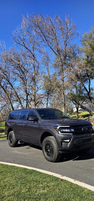

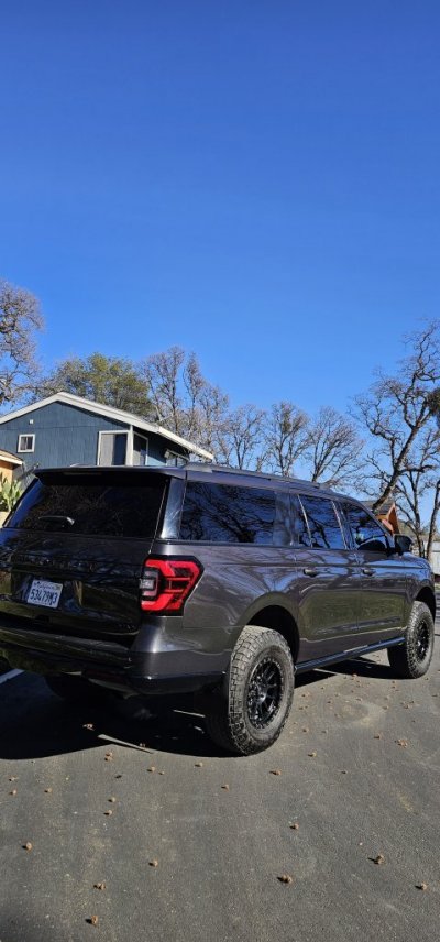

I appreciate the picture and feedback! I did get the Rough Country complete 3 inch lift and some 285/75/18 Coopers
( 34.8 inch ) that are in the shop. But I haven't decided on rims yet since not many options for the 18x9 without getting a really low offset, want to keep +12-20 max. Where did you get the sway bar set up from? We have 6 people in the max at all times and really want to keep that rear end in check more if could since live on country backroads.
If I recall, I bought from Summit Racing. Part numbers 7696 and 7688 I believe are the front and rear part numbers. Double check that though. I found out about them actually on this forum.The rims I have are either +18 or +20. Again- been awhile. But there were several types in that size back when I was researching. One other mention is I trimmed the front of the power running boards by a small amount. They never actually made contact with the tires when turned and deployed, but they were close. Easy to do but you likely should be fine. The tire size you are going to run is a bit narrower than what I’m running. AND- the RC lift may actually give you the full lift as advertised. If we end up in another Expy, I’m going to try RC myself.
