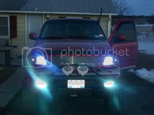

I went the cheap way... non HID retrofit... would still like to get that done... but I started with lightning headlights then went to R8 style headlights with 10K HIDs all from ebay and I have been happy with the set-up.... also have HIDs in the stock fogs... 10K as well
