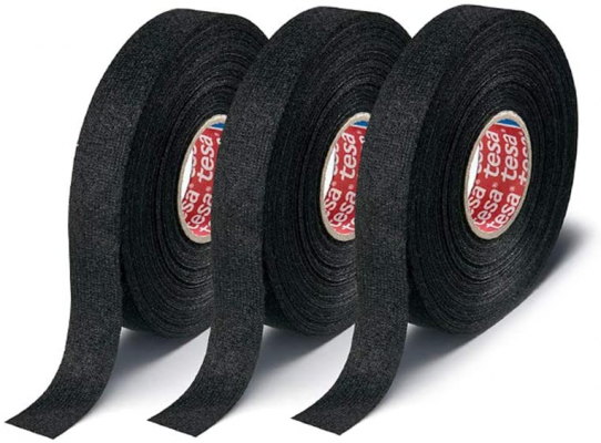

I fixed this by removing the door panels and then unbolting the arm rest from the rear of the panel and adding felt tape between the armrest and door panel. There's about 20 5.5mm socket size small black screws that secure the armrest to the panel. Check Amazon or Google and search for Tesa 51608 fiber cloth tape like the below which works great for rattles between panels.
Thanks for the tip! Amazon will be bringing me a roll of that tape on Tuesday. We’ll see how it goes.
I had a 2020 rental Limited as a loaner for a couple weeks and it didn’t do it. If this doesn’t work, I may start searching used auto parts sites for door panels…

Well @BMW2FORD I got the tape in and took the doors apart yeserday. Once apart, I was able to easily identify the rub and creaking points. I applied a layer of tape everywhere. I also wrapped up a couple of the posts where the trim slipped over it before getting screwed down. I even put it in places I didn't think were creaking just in case. As I disassembled, I also determined that a lot of the little bolts weren't really tight in the first place, which likely contributed. But once reassembled and tight, the panels now make almost no noise. I can rest my leg against the door while driving and not contemplate driving the truck off a cliff, so I consider this a success!

Glad it worked. I wish I took pictures when I did this repair but didn’t think too much about it and thought I was the only one. That felt tape is awesome, I always keep a few roles and add some here and there when I have something apart. European cars use it to wrap wiring harnesses.

I put the second door back together and remembered as I put the last screw in that I forgot to take pics. I fully intended to do so while I had it apart and completely forgot. Thanks again for the tip. I have already thought of a dozen uses for that tape :)
