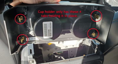

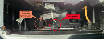

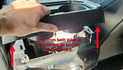

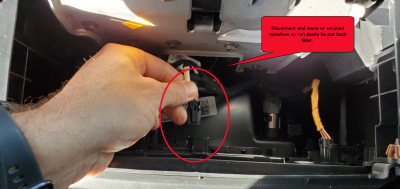

Just disabled rear radio controls. Not a lock per se, but it works. My kids are not as well controlled. Also found outlast night, adults may hit the buttons with their feet as they cross their legs. So here you go. Not ideal, but super quick and super easy.
Once the cupholder is off, look down into the space behind the panel and you will see the following connectors.
