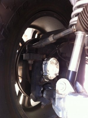

no, no dragging. how far in is this hub actuator? This is my 1st 4WD car.
The locking hub actuator is the circular thing that is currently covered with metal tape in my pic. There are 2 hoses attached to them up on top. (I have temporarily removed my half shafts for the moment)...
The actuators works like this..
If a vacuum is present, it pulls the gears away and 4x4 is disengaged.
If there is no vacuum, the gears are engaged for 4x4.
Therefore.. You will need to do some troubleshooting... All you need is a vacuum pump/gauge.. Attach pump to the larger of the vaccum inlet, and pump to around -20psi. if the vacuum holds, then the actuator is good. If not, then it needs replacing.
If your actuator is good, you will then need to move higher up the chain.. and test the vaccum hoses..
To test the hoses, you will need to locate the IWE solenoid on the firewall passenger side. Put your pump in the larger tube, and test vaccum. IF there is a leak, replace tube assembly. If not, replace the IWE solenoid ($30).. Replacing this is a common issue also..
Actually.. If you are willing to just spend around 30-40, you can just replace the IWE solenoid.. No need to get dirty... Most of the times, this fails first anyways.. Causing the problem you just discribed...
Good luck :)
