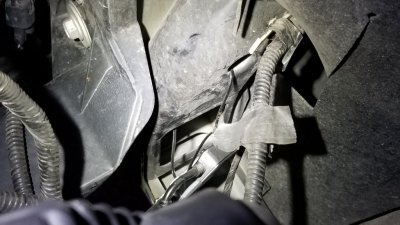

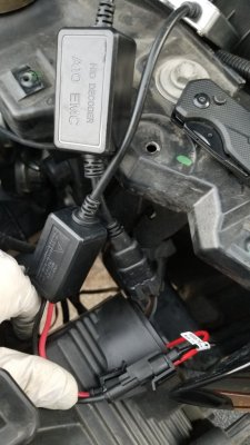

I took a few photos of my install. First using the connector as provided didn't work as the polarity was reversed. The first photo shows me documenting what color goes where. The second photo shows the adapter has a nice +- and, well, direct connection doesn't work. 20181016_182244.jpg 20181016_182028.jpg

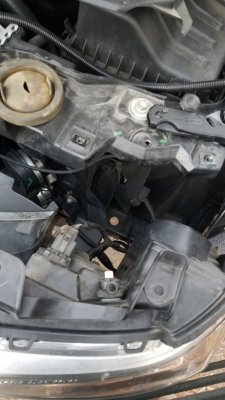

Here I made a small cut into the dust cover. Feed the wires through before installing them in the connector (keep hole small)
I zip tied the controller to the vertical beam next to the one with the quarter like hole.
Snug up the controller & it's rattle free.
I seem to be having a problem with the left light bulb beam pattern. I'll check it out over the next few nights & provide an update.
I've used LED bulbs & they just don't pattern well in projector housings.
