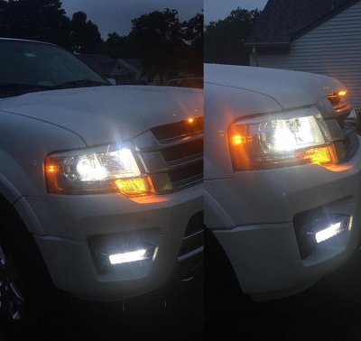

The low beams seem very dim on my Expy, so I ordered some Xenon HID's for it. Would these work as a straight swap for the factory Halogen's or do I need some sort of conversion kit?

Do you have projectors (look like a spherical glass lens ball thingie)? If yes, an HID kit (with the ballast and wiring) is the minimum, and a relay harness and/or "canceller" capacitor set may be necessary if they flicker.
If it's just bulbs, nope, you can't plug em in.
If you don't have projectors, it's illegal and unsafe and impolite to others and will get you ticketed (pretty sure you DO have em though)

Thanks for the response, I do have projectors. Are there any kits/bulbs that folks on the forum have had good success with?

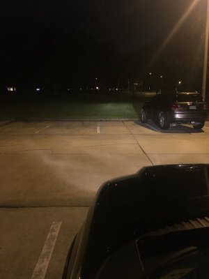

do you notice an actual improvement in the beam brightness, or is it just a different color?
Yes output is much better. Beam pattern is very crisp and I am very pleased with how easy the install was. @chuck s these wereni stalled in my projector housing with no issues.

Ok, so I went with these HID's in my low beam PROJECTOR lights. Installed them on Friday and have used them extensively over the past few nights. All I can say is WOW. Such a difference over the stock Halogen's. All of the reviews and info I've read say to go HID's with Projectors...and I'm glad I did. Brightness, depth, color and overall visibility are all just perfect to my eyes. My wife is thrilled which is the icing on the cake lol. Night and day difference (pun intended)
