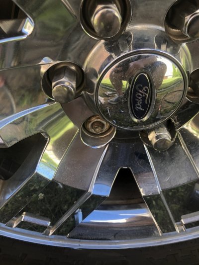

Heres the picture of the broken nut:
I tried to just move onto a different wheel, went to the front driver. Impact wouldnt budge a single one. Breaker bar....SNAP. Thinking another nut broke, I don't even know what happened. The lugnut just spins freely in either direction. Snapped stud? Wouldn't it just fall off then? This won't pull out. Maybe the lug snapped again but the lip of the stupid chrome cap is holding it on the broken nut.

If you look at OP's picture ... the part of lug nut that sheared was not contacting ANY threads on the stud. ALL the stud threads are in contact with the part of lug nut remaining.
I bet that lug nut metal is soft. I'll bet you could use a metal chisel to lengthen the remaining faces of the lug nut and THEN get enough purchase with a bolt extractor to remove. Just a theory. Job like this is best handled by a known process not a theory though IMHO. This can downhill fast.

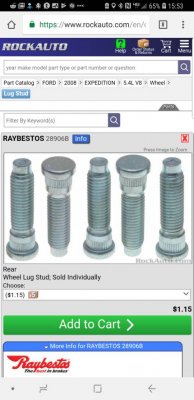

Studs are usually replaceable.
There is a tool meant for pressing them out.
Here's directions for doing it on the front wheels of a 2x4. 4x4 is probably similar. Rear procedure is shown as well.
Front studs can be done in-vehicle.
Rear bearings have to be removed and done in a bench vise.
https://workshop-manuals.com/ford/e...pair/front_suspension_rear_wheel_drive_(rwd)/

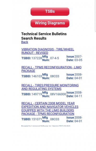

Also, sadly, no TSB on this. Only two for the TPMS,and one for the wheel-run out.
