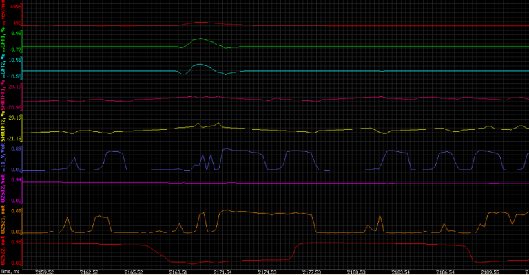

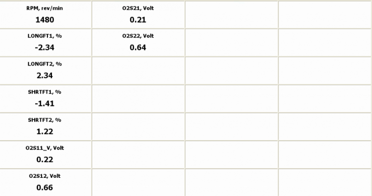

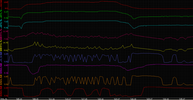

I keep looking at data on Forscan and all of the odd information I am seeing is on bank 2. Both O2 on bank 1 look good. The upstream is switching and the downstream is steady. On bank 2 the upstream doesn't look perfect, but it does switch. Every time I feel the misfire at a base idle, the downstream O2 voltage drops quickly showing lean but recovers until another misfire event can be felt. The STFT does have some spikes in reaction to the lean condition. But nothing regarding the fuel trims is alarming.
I don't have any codes, active or pending. My fuel trims don't look horrible, but they are trending to lean. I did put 3 quarts of Seafoam into the tank at the last fill up. My mileage over the last couple of tanks has gone from 14.8, 15.3, 15.8 to 16.1.
