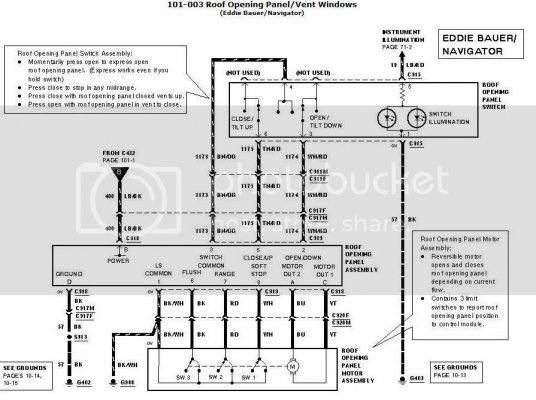

In a previous thread I was having trouble with the power windows, flip windows, moon roof , rear wiper, running board lights and interior lights.
All this was fixed by replacing the battery saver relay; except the moon roof. It is open and will not close.
All the other parts on this circuit are working except the moon roof.
I checked the current going to the moon roof switch in the overhead console and two wires only had 5 volts of current. They were both white/ red stripe.
My Haynes book does not give a wiring diagram of the moon roof.
Why are all the other parts on that circuit working and not the moon roof? This is a 2000 Expedition. Thanks<><

Here's the wiring diagram.
The WH/RD wires you spoke of seem to be the "open" wires.
