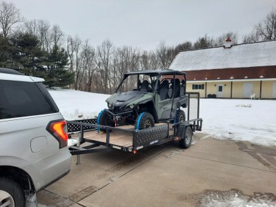

I have a 14x7 single axle ATV trailer (1500lbs) and I get roughly 14.5mpg pulling it at highway speeds... 12.5mpg with my Wolverine X4 on it (3300lbs trailer/sxs).
I will mention this was on my 20" winter tire setup, I have noticed a significant drop in MPGs with my Stealth 22" oem wheel/tire setup.

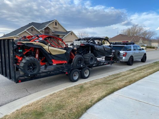

I get 13-14 with my set up. Best MPG is at lower cruising speeds. Take the big wind break off the rear and your mileage will improve a little. Even with the mesh the air still packs up on the tailgate and drags you way down. My buddy borrowed my trailer and smashed the tail gate. Just driving it empty the trailer feels so much lighter and easier to pull with it gone. Going to leave it off this summer and see how big a pain it is and what the MPG is after a few trips.
On the way to some fun! Looks awesome @Fozzy
bill_b
Jul 7, 2019
128
70
Pittsburgh PA
Wow awesome setup!!! I have noticed that with my mesh gate too (mine will fold down flat when unloaded).
I have a 12’ single axle that is built just the same and it has a larger ramp. It pulls harder empty at freeway speeds than the 24’ loaded. Big old air brake hanging in the wind.
Yep the expanded yard maintenance trailer ramps are a massive drag. I convinced a buddy to ditch his gate/ramp he gained 5mpg on his trip vs the prior year with the same trailer. He was shocked said it even towed noticeably more stable. He had a shop fab up ramps that drop into a channel for easy setup and had them put slots on each side where he drops them in sideways on each side of the trailer for storage
