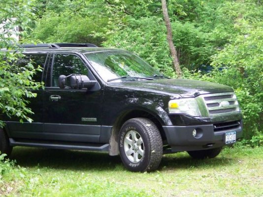

I am using basic flat rubber mudflaps mounted in the front wheelwells. The main reason I put them on was to stop the stuff from building up on the running boards.
You can see them in this picture.

I have the fixed running boards on an XLT. I haven't seen the power boards so I can't tell you if they would hit.

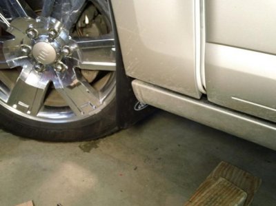

I ordered a set for my KR with power boards. I'll take some pics and let you know how I mounted them when they get here and I get them installed. I'm not just putting them on because I'm tired of all the snow, salt and gravel on the board when it comes down, but because they said I couldn't.
Miekk
Jan 9, 2012
156
32
Madison Lake, MN
No issues whatsoever. Misses by 1/4-3/8 inch.
I used the two factory screws on the front actually using the hole locations in the directions. I added a third with a stand-off to the inner fender well. A long screw and a piece of 1/4" fuel line trimmed to the length I wanted and it was perfect.

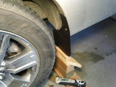

The rear I lowered about 2" from where the directions said to install it. I used the only one factory screw there was and added two more.

Next time (and I may still do it) I'd lower the front at least an inch also.
The extruded power boards can be loostened and slid back slightly if ever the front would want to catch on the mud flap.
