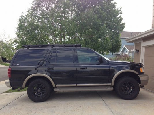

Thanks Rob. It's been a journey. An enjoyable one. The old wheels are long gone. Those thing were horrible. To be honest, I wouldn't want to slum it around on those ugly things for half the year just to save my inexpensive current wheels. Plus they don't use salt here so I'm not worried at all.
Also, got the windows tinted today. I went with 30% on all windows.
Just in time for the Mercury to hit the 90s.

Looks good Tom, my F150 fronts are 30% too and love the look. Want to do my Expy but windows are too scratched up and afraid they will really show the scratches bad. Watching the wreckers for better ones.

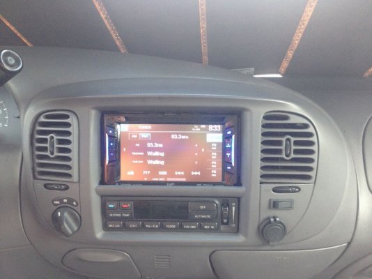

My late 20th century truck has finally entered the 21st century with the addition of a DVD player with Bluetooth.

Got the backup camera wired up and working. Probably need to adjust the parking assist lines on the head unit, but it works pretty good.

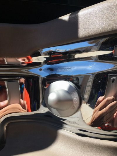

I don't like chrome but since I have it, might as well make it look decent.

The front bumper is pitted pretty good. Not sure if there is too much hope for it to look great.

Ya Tom I ran out of "elbow grease" on my 3rd one so I blacked out the bumpers lol hehehe sure looks good though. Any chrome thats clean will catch the eye. Great job buddy

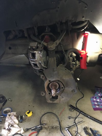

Replaced both wheel bearing with Timkens. Pretty sure they were original. No noticeable play in them but I thought I detected some groaning from time to time. 195k miles.
Pretty easy job. 35mm on the axle nut which my impact seemed to easily handle. None of the bolts holding on the caliper or bearing themselves posed any issue either.

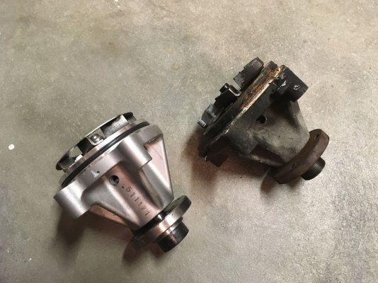

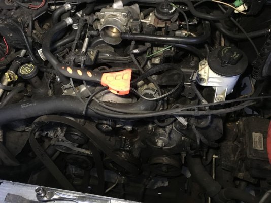

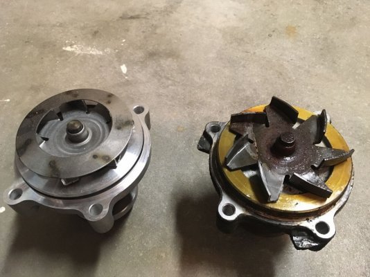

Did the water pump and fan clutch last night. My AC performance on hot days while not moving fast was not the best. But once on the highway, it cooled like it should. It's not the blend door and the AC charge is pretty good.
I figured they were both original so if it was my clutch going bad, the water pump was nearing its end as well. I got a new Motorcraft pump off Amazon. The impeller design has changed over the years. The fan clutch is a Hayden heavy duty unit.
Getting the fan/clutch/shroud out is pretty easy- the second time around. I washed the radiator fins out really, really, really well and as a result I thought it was leaking when I started to fill the radiator and went back in with the intention of removing it. Turns out the fins trap a ton of water and that is what I saw dripping. Once I started the motor, the fan sucked all that water out and all over the engine bay.
The new fan clutch seems to draw way more air through the radiator/condenser than the old one. I did all the tests prior to determine if it was bad and didn't come to any conclusive evidence other than seeing somewhere that a fan clutch will lose about 100 RPM a year. If that's true, I was down 1600 RPM. The true test will be today.

Tom, did you take a good look at that new impeller design? Off the cuff, and looking at the images, it makes me say "hmmm" with regards to how the shrouded portion is affixed to the blades. Spot welds? Looks well retained?
Probably just enginerd's brain going into analysis paralysis...
This is all PM I need to do with my truck also. I need to take out the heater core so might as well do this at the same time while the system is drained.

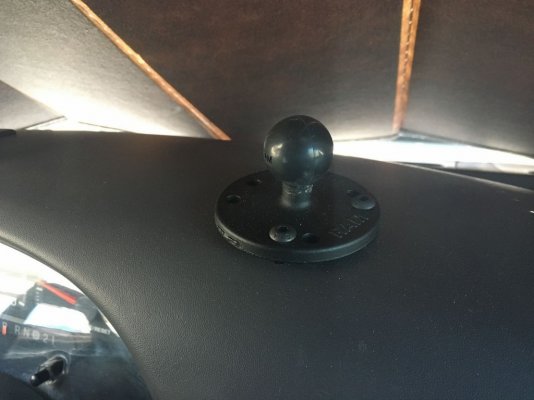

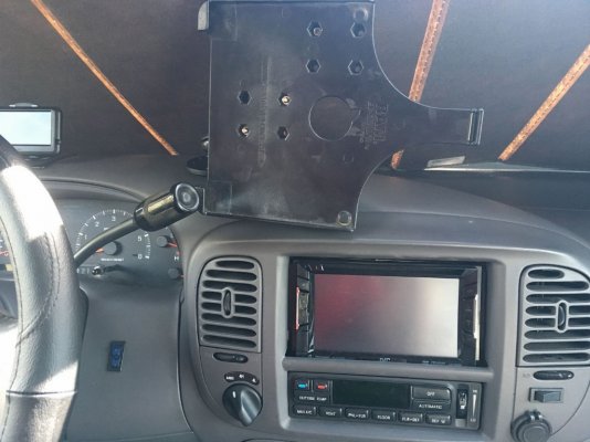

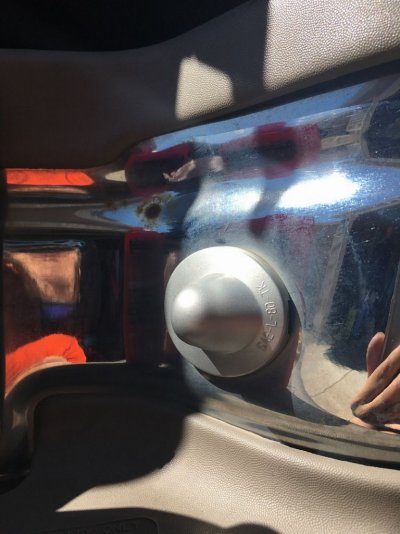

Added an iPad mount to my dash. It's a Ram Mount with a surface mount. Suction cup mounts are OK but it puts the iPad farther away, they aren't as stable and I can't use my sun shade with it stuck to the window. Only the surface mount ball is permanently in place- the arm and iPad holder get removed between trips.

More pics of Ipad mount please
Here's the surface mount:
Take a look at the Ram Mount website for more detailed pictures of the mount and arm- they have several different styles. Someone gave me this one.

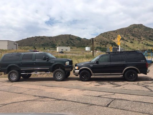

A guy at work drive this Excursion:
Just when I think my Expedition is big, I go and park next to him like this. This much lift, IMO, is too much. Plus it's impossible to get this much lift on an Expedition and keep the torsion bars.
If I do lift, my end goal is to still be able to park in my garage. And there's not a lot of room above the roof rack now. I haven't measured it yet (just moved into new house) but there might be 2-3 inches available.

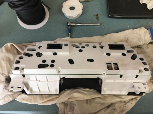

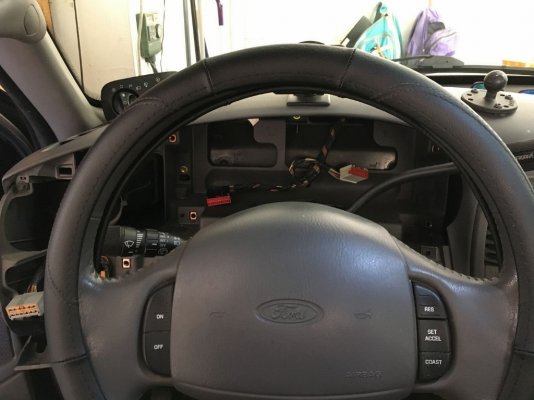

Like many 10th gen F-150s and 1st gen Expedition owners, I've had issues with my odometer not always displaying. After watching a YouTube video or 2, I took the instrument cluster out and soldered the circuit board where the problem is supposed to be. I may have seen a crack in the solder joint but it was pretty small. My odometer would go for a long time working just fine and only be out for a short period so this repair will take awhile to show up as fixed.
I didn't get any pictures of the process or with the circuit board out- there's a bunch of videos on how to do it.
