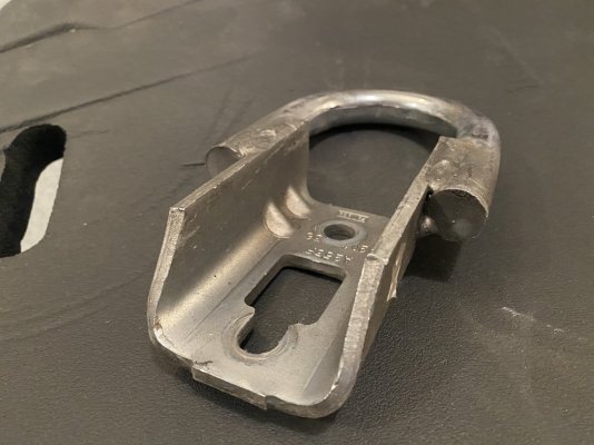

The instructions tell you to remove the little skid plate that protects a couple of wires. It never tells you to put it back on. The bumper does not have a hole in it to let the skid plate go back on. I was worried about these wires and cut the tab off the skid plate and put it back on.
The skid plate protects these wires. Looks really easy to tear them out. The original LGE-CTS build was a two wheel drive model and did not have the front diff.

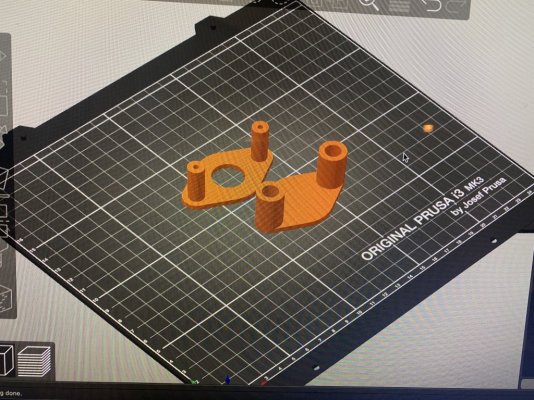

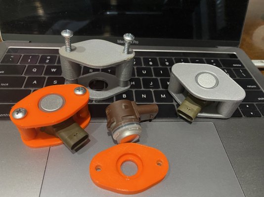

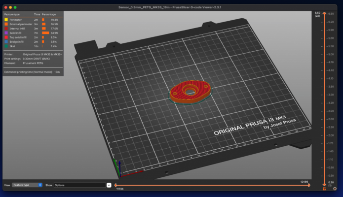

The bumper is very solid and strong. You still keep the factory crash bar but this will add some good crash protection and coverage for the radiator and CAC. I have taken it on the freeway up to 90 MPH. I could not detect any new air or road noise. It will be interesting if this affects my MPG or engine/trans temps. I does warn you of a "Parking Aid Fault" every time you turn it on and flashes a picture of the Expy with a warning sign on the 8" screen every so often. I have all six sensors disconnected. The active cruise control still works and so does the BLIS. I plan on 3D printing new mounts for the sensors. From what I have looked at I will need two different designs and maybe even an external mounted one. I just need to get my calipers and fusion dusted off and start prototyping brackets.
