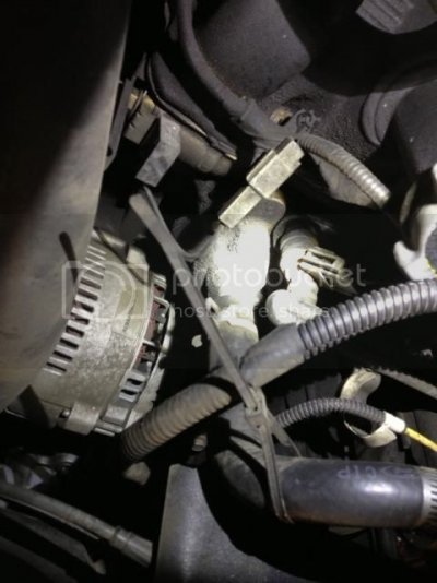

Wow, lucky I found this when I did. It appears I have the identical problem. I cannot believe the part I need to replace is plastic, maybe its been replaced before? It REALLY looks like aluminum. I was hoping it was just a paper gasket underneath. Problem all started a couple weeks ago when I began to smell radiator fluid. I monitored the levels and didnt see any noticeable drop, I attributed it to the hot weather we have been having and assumed it was an overflow. Tonight when I went to the store, I noticed the smell even more so, and decided to check it when I hot home. I did notice it was running just a tad hotter, but cooled down once on the freeway. When I got home to check where it was coming from, I could hear a slight gurgling at what I guess is the manifold where the hose connects? I checked the reservoir, EMPTY!
Not looking forward to this repair, any tips from any experts appreciated in advance.
Just follow the hose as it comes away from the firewall, and heads south. Its the apparatus it connects to, is where it appears to be leaking.

Yeah, the aluminum piece the hose attaches to that your referring to, is attached to a black plastic intake manifold. You can google search 5.4 plastic manifold and get all kinds of info on them failing. I replaced mine with a Dorman plastic manifold because they redesigned it and made it better than fords original. I am not a mechanic by any means, but I enjoy working on mechanical things, and this job wasn't bad at all. I took my time, several breaks, lunch, and total time on it was 5 hours just using a standard socket wrench...no air tools. I also took pictures all the way through just in case I needed to refer back to them. Off the top of my head I used a 7mm socket, 8mm socket, 10mm socket, flat head screwdriver, several different length extensions, 1/4 drive ratchet, 3/8 drive ratchet, swivels for both, torque wrench, a special brush that fits in a drill to clean the surface area, some purple power, a small wet/dry vac, something stable to stand on to reach the back of the motor easier, and a couple of old rags. A couple of things I would say to look out for is be sure not to lose the o-rings on the injectors, once the old manifold is out be sure there is no coolant at the bottom of the spark plug holes...if there is be sure to remove it or it may cause a misfire. And the biggest warning of all is to be sure not to drop anything down into the motor while the manifold is off.

might as well replace the intake. you're going to find the plastic cracked under the crossover pipe!
