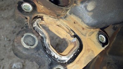

Maybe this new pic will help a little. The crossover is leaking on the backside of the left side where it attaches to the plastic intake manifold. I circled the area in red. After a few lengthy phone calls I found out the part is called a water crossover. there is an o-ring at the connection on both sides and I had to order them. Part number ES71213 at advance auto. Now that I have that info I'm HOPING I don't have to remove the manifold to install them. Anyone ever taken this crossover off before and know that answer?

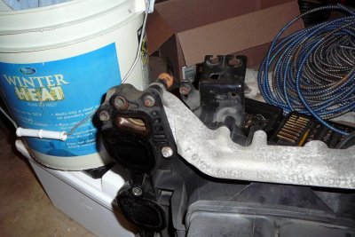

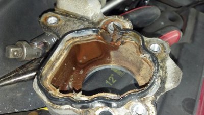

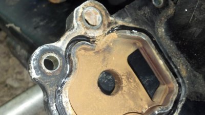

Just pulled down my original intake manifold from my garage attic storage to check.
There are 6 - 8mm bolts on the underside of the plastic manifold. 3 on either side. Posted some photos below.

Those pics are PERFECT! They still wont be fun to get at, but at least now I can see what I'm up against. Hope to have the two seals before lunch tomorrow, and get to work on it.

Yes, the first pic that has the arrow pointing is the joint that's leaking on the backside.
