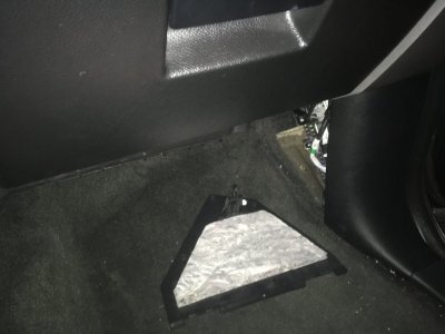

BrianB
Dec 13, 2016
Orlando, FL USA
Found the door unlock code. On my 2015 Expedition EL XLT, it was hidden behind a plastic fuse panel cover on the passenger side near foot level, 5 digit code with a L appended on a white sticker above the fuse panel.
