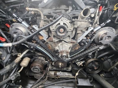

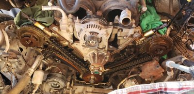

Do you have pictures of your engine after the phasers were installed and you did the timing procedure where we can see where the tines on the phasers are facing? I’m stumped. What is the degrees of advance @ resting position reading on both? I believe at rest it should be full advance. At WOT it should be at full retard on both banks. As you increase in the revs do both retard? Is one side staying in advance? 60 degrees of retard at low speed does not seem right either, like I said that is wide open throttle position. Trying to get a feel of which bank is screwing you here.

Yes I have pics of the installation. Driver's side marks on the L and passenger side on the R.

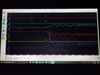

I'm going to attach a picture of the timing going off while stopped.

Don't know why that's so blurry. The graphs are:
Bank 1 vct duty cycle
Bank 2 vct duty cycle
Bank 1 vct error
Bank 2 vct error
Bank 1 vct advance
Bank 2 vct advance
Throttle position.
Everything operates normally until it decides to lose its mind.

really odd about your timing going out of whack. Comparing it to my phasers your look to be at a different angle. Your matches what I have seen in the youtube videos and others though, so I have no idea. .
