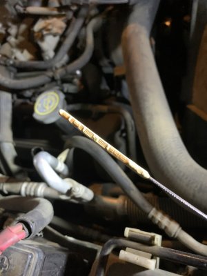

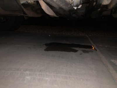

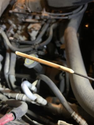

Well I think I found my leak! thankfully not the transmission like I had thought. But it is the transfer case. Looks to me like there is a crack around the drain plug. Any thoughts on how to fix this guys? My first thought was to drain the T-case (again) and JB weld that crack. Think I should do that or just clean it up and throw some RTV on it?

Looks like JB Weld for Aluminum! That should work. Ill see if I can find some local this week. And 2 more quarts of Transfer case fluid.

Think those are just casting and not cracks. More likely theres a washer missing on the plug. If it is a crack make sure to rough up the surface good for adhesion. But if there is a crack right there I'd say it extends to where the plug is (maybe over-tightened) and that will be real hard to repair.

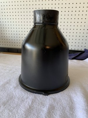

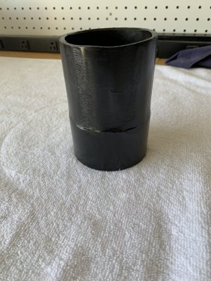

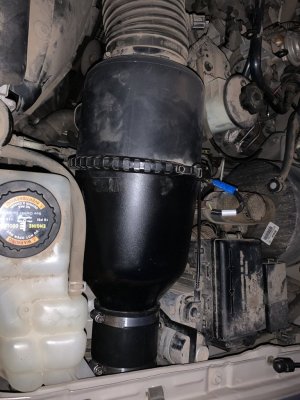

Well time for an update. Couldn't find the Hy-poxy alumbond stuff but I did find a JB weld that said it was for aluminum. Tried it out and it worked out OK. Slowed the leak but it still has a small drip. Might try to re clean it up and add some. We'll see, not sure if I want to buy two more quarts of transfer case fluid. On another note I bought wheels! found them for a good deal on Offer up so I went for it. I redid the hub caps for stock/custom look :peace:. Also started a Gotts mod to get this ole 5.4 some more air!! I cut off the end of the stock housing because it was only 2.5" ID. Epoxied on some 3" the same length as what I cut off (don't judge my epoxy job). And boy am I getting tired of sanding the piece that goes through the fender. Might borrow my buddys belt sander. Ill post some more pics when its all done.

I had those same wheels on my 2000. I had different center caps though. I really like the Ford logos you put on them.
