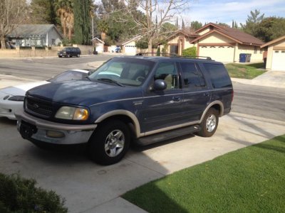

Meet the beast….
And I had ordered the DVD prior to getting on this forum… Whoops

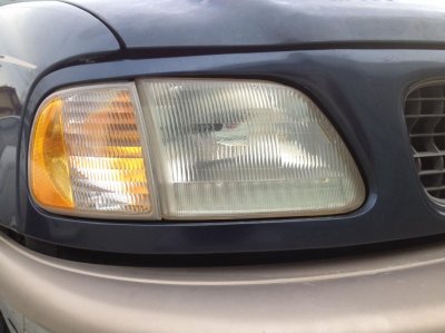

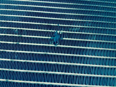

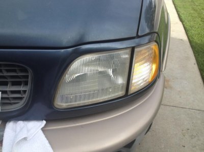

Headlights polished, antenna in , engine bay minor detail. AC condenser has a hole in it.. which in itself isn't bad what bends my rod is the HUGH lump of J & B weld.. Up high & centered.. probably when installing the new radiator by the " mechanic ". New condenser on order. The heater ( both front & rear ) are not HOT but since the flush… better 80 degree discharge air… both hoses are at the same temp to the core…I tried blocking the radiator with 2 moving blankets to raise the temp.. no deal.. airs moving through from underneath… well I won't have to worry about cooling issues...
  • P:S after.jpg
    P:S after.jpg
  • D:S after.jpg
    D:S after.jpg

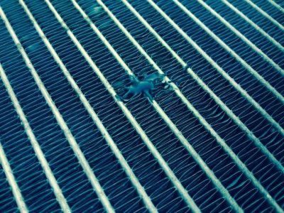

Tech maroon of the week..The previous MAROON tried to patch a 100.00 part. Now I Love J & B Weld almost more than a great cheeseburger ( but not as much as bacon ) .. But you DONT USE IT TO REPAIR AC condensers.... DURRRRRR 250 PSI pressure 270 degree heat... just will NOT work.. PERIOD.
Finished up the day with Multifunction turn switch, license plate & running board lamps.. the truck is now safe to take on the roads.. all the back end interior is pulled apart to fix the " factory " sub... but we are a GO HOUSTON...
