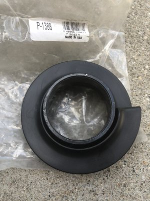

For this option you will need to cut your OEM spring perch off your OEM shock and reuse your OEM spring and top mount.
You can try to locate the OEM spring perches from an older Expedition (I had zero luck with this).
However, I was able to source the lower spring perches from NAPA as their models still use a removable spring perch. Full disclosure this was an extra special order that had to be done by the regional NAPA manager as the perches alone are not normally an orderable part. The part number is P-1388 and does not show up on their website nor did it show up in the stores ordering system. My NAPA guy rocks so your results may vary. They cost me $12 a perch plus shipping and a 2 week wait.
