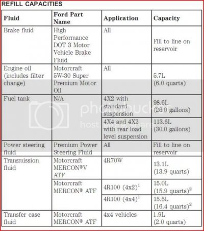

Hi guys and gal's FNG here. I tried searching but I cant find the oil capacity of the 5.4L 99. I have to go to bed so I cant burn through all the post's that come up with "oil" in the thread. I am part of a motorcycle forum and know exactly how "oil" threads go...... all I need is the ammount to put in. I am going Motorcraft synthetic and filter.
