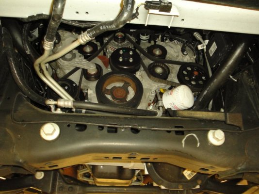

I'm not sure why you would want to put on a longer filter, as the standard Motorcraft FL-820S has proven over many years to be a very good product and has quite a bit more filter media than the FL-500s filter used on 2015 and newer models.
Then there is fitment to consider.
Below is a picture of the 2011 with the standard 820s filter. As you can see at the current length, it is very close to the bottom radiator hose. Installing a filter with a longer body would cause the radiator hose to rub against the filter and would eventually wear through the hose, leaving the vehicle on the side of the road.

The WIX 51087 is about 1.5" taller, same thread and gasket size, but you're going to run into clearance issues since it's so much bigger. And I don't see in my catalogs anything that's a whole lot wider, since the FL820S is already a pretty big around filter. You could probably get somebody to fab you up a remote mount filter and hang a HONKER of a big ol' diesel filter from it if you really wanted to, but I don't see anything off the shelf for the Expedition. I'd bet somebody makes one for the F150 that could be modified to work.
