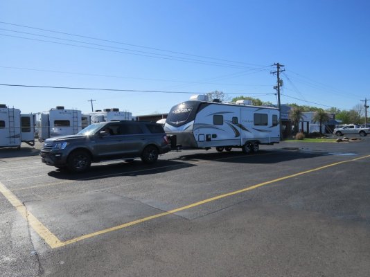

Hey all, new member to the forum, but not new to reading the posts. I have a 2021 Ford Exp Max 4x4 (with max trailering). I’m looking at a TT with an advertised dry weight if 6,040 and a 800lb hitch weight. I’m worried I’ll be over my hitch weight when loaded. Any thoughts/opinions? TIA

Just get a quality weight distribution hitch. The key is dispersing the weight of the rig over the trailer and truck axles. I'm also using 10 ply BFG's aired to 65 psi when towing to cut down on side sway. Using a 10K pound 4 point Equalizer hitch and towing a 6400 lb dry weight Cougar 25RDS that can gross out at 8800 lbs. Hitch weight is around 1000 lbs which is probably max being loaded lightly in the camper and truck. Handles good at 60-62 mph on a not so windy day!

Need to find out if the hitch weight is based on the dry weight or GVWR of the camper. Some campers by design put more load on the tongue. The problem is that if your tongue weight is too high, you may exceed your axle ratings even with a good WDH.
