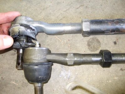

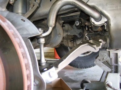

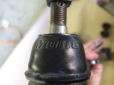

OK guys, the project is all finished. HUGE difference in handling/steering and ride comfort. I cannot begin to explain the difference these small changes made. Got it back from Firestone (alignment) on Friday and installed the front shocks yesterday in the rain.
The truck had OEM motocraft shocks in all four corners... and they were SHOT. The previous owner was way overdue replacing them. And let me just advise anyone thinking about replacing the shocks to not go cheap because these bad boys are not the easiest things to switch out. Go with Bilstein (lifetime warranty / lifetime qualty valving) and do it ONCE.
Rear: the RH side is easy. The LH side upper bolt is difficult to get to. I recommend using a long extension or two mated up and reaching the bolt from behind the spare tire. And you don't need a wrench on the nut on the other side of the shock. It's mounted to a HD clip that will fall off as soon as your shock comes loose. It's a PITA to hold that clip up in the top shock mounting bracket and shove the new shock up there at the same time...so beware. I used a little grease on the shock rubber so all of that would slide in a bit easier. Oh yeah, do the RH side FIRST - it's much easier. You'll see how it goes down, which will save you a ton of time on the LH side. I did the opposite and spent way too much time playing with tool combinations until I figured out (a) I didn't need to hold the nut on the top shock (b) to use the long extensions and climb under the truck - way under.
Front: These are much easier in a ways... much more difficult in others. You will need to place a floor jack on the side of the front crossmember where you're removing the shock and a HD jack stand to put under the lower A arm, which you'll need to lower the truck's weight on the A-arm to get the shock to push up far enough through the mounting hole to thread the top nut. I read about this on multiple forums that top threaded shaft on the top of the shock is not long enough.. and it's true. Also, you will want to use a prybar to pry under the top shock mounting bracket on the truck frame and push DOWN on top of the top of the new shock bushing to get the shock to feed under the top shock mounting bracket on the truck frame. It's just too difficult to try to "man it" (compress the shock by hand) into place. I tried...
Huge difference, guys. Do it.
I probably have $450-500 in this. And I'll say that while replacing the original tie rod ends may have been unnecessary at 108k (cost $120? +$75 for the alignment), I'm glad I did it. If you are going to do anything, replace the $10 per side front swaybar end links and do the $250 shocks all around. WOW is all I'll say!
