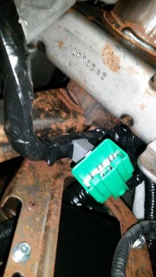

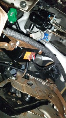

Park brake light stays on - pedal returns ok and i can FEEL it release on a hill

Also, normal brakes behave normally, brake fluid level correct
Ideas?
Does anything stand out / look wrong? There IS some weird green connector that appears unused, but no sign of anything that was plugged into it

2012 gator, same park brake system as 3rd gen expy
Chime sounds and dash warning about brake on as well

Btw happened after changing air filter, anything i could have knocked loose there?

RESOLVED : n/m, i somehow kicked loose the rubber stopper on the pedal that engages the park brake light switch
