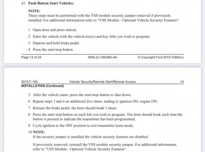

I have a 2019 Expedition XLT 201A and added perimeter plus (JS7Z-19A361-A) and now have remote start using the factory key fob by pushing lock-unlock-lock.
I decide to add the long range remote “js7z-15k601-b” with ultra long range extender antenna “js7z-15603-a”
Question is, does anyone know how to program the long range key fob? Are there instructions for the long range remote start fob programming available somewhere for Expeditions with push button start? Thank you
