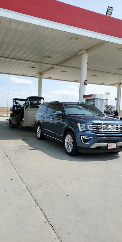

Lots of Ram 1500s and Expys in here, I have the same and have towed with both. I took the Expedition with 2 side by sides on a 20 open trailer to the Black Hills last month and it was more enjoyable than with my pickup for that load. Quiet, plenty of power, and great ride. I don't know if I'd pull my 29' enclosed aluminum snowmobile on the same trip in the winter without the pickup though, stability with the crew/6.5' box + 10 plys makes a huge difference with a longer trailer.
