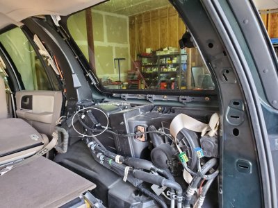

Hi everyone, the popping noise your are hearing is the blend door actuator that has gone bad. What happens is the gear wheel in the blend door wears out on one side and doesn’t fully rotate anymore. When it gets to the flat spot where the gears are gone it pops and give That flapping sound. You’ll need to replace the rear blend door actuator. There are two of them. U may be able to pry out the top tray cover to gain access to the actuator without removing the whole rear cover. Below is an image of it. When you open your old one, you will see the little gear wheel, size of a quarter where the gear teeth has worn off. It’s not a hard job at all. Goodluck

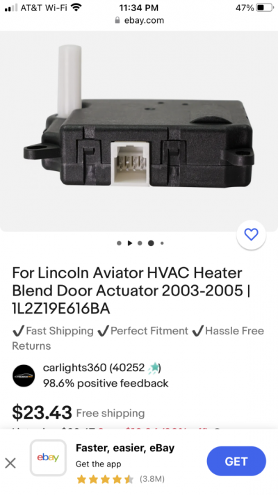

There are two white boxes, these are damper switches one on the side and one on the top under the cup holder and under the top tray. They each have a clip wire going to them. These are the damper switches that open and close hot and cold high and low air. These fail in time. They are not expensive but a little awkward to replace. Use a magnetic that driver don't drop your screws. Really pretty simple. You can run it and feel which one is clicking replace that one first.
