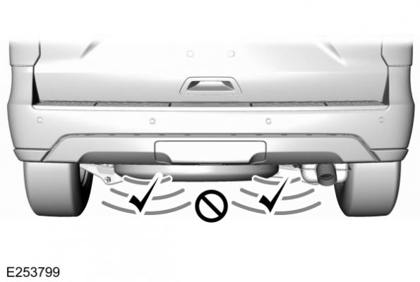

My 2020 Window Sticker lists it as: LIFTGATE - HANDS-FREE
I love the option! Just don't do work around the rear of car with the key fob in your pocket. I have had a couple of times where the liftgate has opened by just stepping a foot under the rear bumper.
If you have it the point to swing your foot under the rear bumper is the outside edge, right or left side, of the panel you remove on the rear bumper to access the hitch....

I guess I am in the minority here, as I tend to use mine quite a bit and spent time understanding how it works. I have discovered four things: (1) if you have the towing option the sensor is on the right side of the read bumper ONLY, and if you don't it is in the center. (2) you have to get close so your foot gets to the sensor. I got on the ground and found the sensor, so I now know exactly to swing my foot and how far it need to go; (3) medium speed kick is the best method. Too fast and it does not pick it up and too slow gives the same result; (4) STEP BACK .... which many of you have figure out.:emotions122:
I now get mine to work about 90% of the time, however the 10% is normally when it is raining, what I am carrying is really heavy, or I am trying to show off to my wife :fca5278e:
Same here - use it all the time. However, with the tow hitch, the sensor is on both sides... it even states so in the manual. You can kick at either veritcal join line of the hitch cover and it'll open. On the 2020 anyway.
I do get the occasional accidental activation, mostly when I'm hitching and unhitching the boat or travel trailer. I've chalked this up to the rear axle going up and down during the process, tricking the sensor. Also, on tall grass too, I've found that wind waving the grass around can set it off. I've been meaning to have a good look under there at some point to see if I can 3d print something to help.
