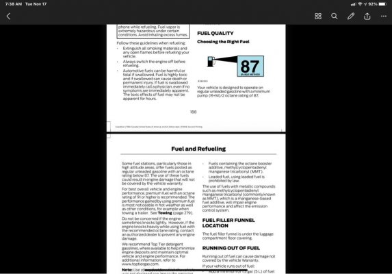

Here is a screen shot out of the 2019 Owners Manual. Clearly states for best performance, which I read as top HP and Torque, you need to use 91 or better octane fuel.

Thanks for the feedback, everyone. I also haven't been able to discover any evidence that premium fuel will yield any benefit other than increased HP and efficiency. So I'll stick with regular fuel except when towing.
