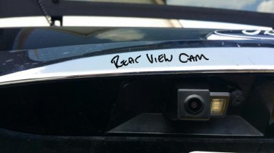

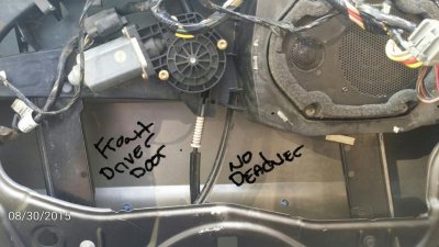

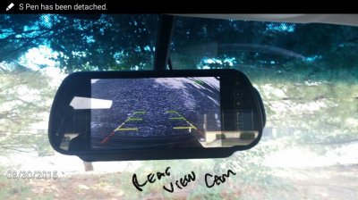

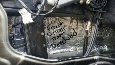

So here are a few pic's that I have so far:

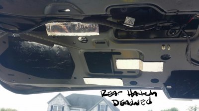

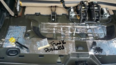

Few more:
2004XLT
Sep 26, 2014
324
19
CT
The rear view cam install is really clean, I like it. I'm considering using deadener, how much of an improvement is it? Also I noticed in the pictures of the trunk and rear hatch it looks like you have the deadener placed in specific locations, how did you determine where to put it? I'm happy with how mine sounds for the most part after going through every rattle one by one and fixing them, but I still have a horrible rattle in the rear hatch by the handle.
I definitely can tell a difference. Closes with an solid thud. Also when I put my woofer back there for a test run a lot of the rattles where inaudible.
For the rear hatch I got good coverage on the outer sheet metal which is hard to tell in the pic's I took ( I will try and get some better ones). On inner metal I just put it where it had the highest pitch when I tapped it.

Was able to get to the front passenger side door today. My wife came out and distracted me and I put it together without taking the pic's of the deadener inside. But you all know what that looks like anyway.
rlnUbyPWXC2xHwrn
I am still waiting on my wireless charging stuff to get here so I can start on the armrest.
