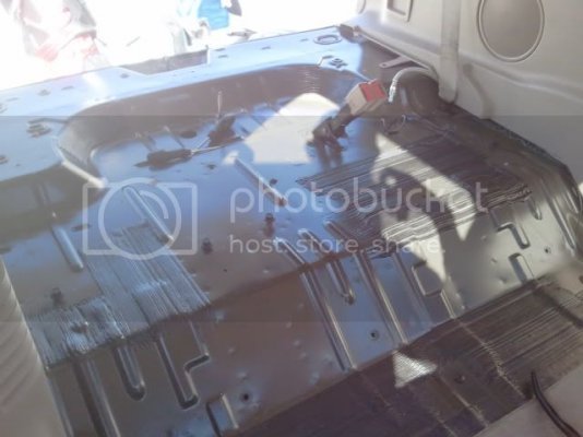

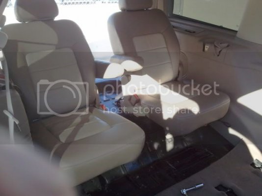

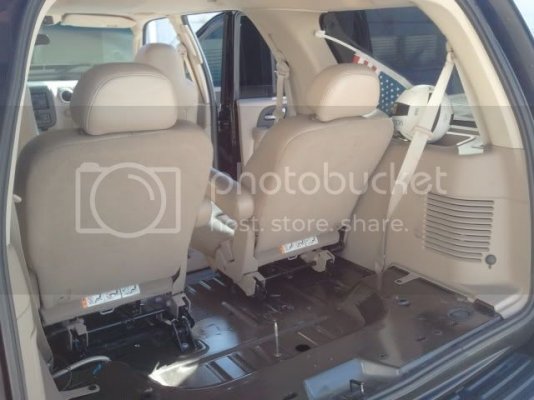

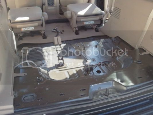

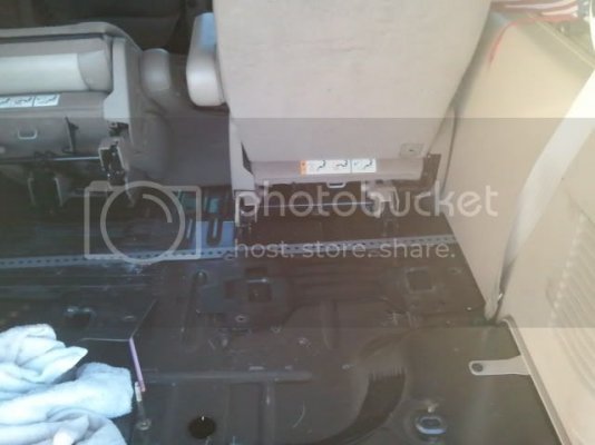

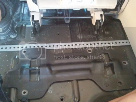

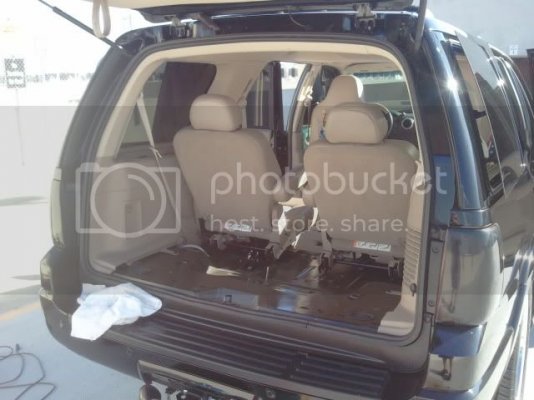

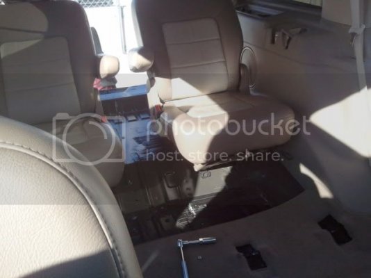

I dont use the back seat too much and I love my middle row bucket seats..... soooo why not move them to the back where I have more leg room??? I started working on it today and it will probably take me forever since I work 60 hours a week. Here it is so far... The seats arent actually bolted down... thats gonna take some time.

Don't underestimate how tough those seat mounts need to be. In the event of a head on collision, if that seat were to come loose and fly forward it could certainly kill the person in the front, let alone if someone were actually IN the back seat.
You want to make sure that the seat bolts go through a reinforced part of the body with a big washer and nut on the other side. Also use grade 8 hardware.
