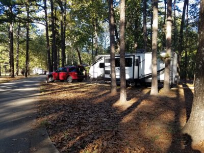

I have a 2017 SWB Expy with HD tow package and tow a 2018 Grand Design Imagine 2400BH. Due to payload capacity, most of the time, my wife will drive our second kid, dog, and assorted other stuff in her Forester. I have a payload of just under 1,400#s and ASSUME I have a tongue weight around 800#s (based on other folks with the same trailer). I use an E4. I get pushed around by semi's, but not sway. I don't like driving more than 3 hours away and I don't go faster than 62-64 mph. I tend to get about 8.5 - 9.5 mpg.

Published tongue weight of my ultra lite trailer is 500 pounds. In reality it is around 900 with water in the tanks. I have my weight bars very tight or sprung to keep the expy level and stable. My payload rating is 1400 and I'll usually have 7-800 pounds of people and gear in the vehicle. The weight police will tell me that's no good and that I need a 1 ton truck, oh well.
My trailer is very low profile and designed specifically for SUV or half ton use (Tracer air 250). No sway and I tow at 70mph without issue. I don't do this full time though, probably 10-12 times per camping season and trips no longer than 3 hours one way. If it were more often, I'd look at a pickup with a higher payload but for occasional use it's fine. The expedition is used 98% of the time hauling 2-4 people around town. You buy a vehicle for its primary use but make sure it can occasionally do more than that.
