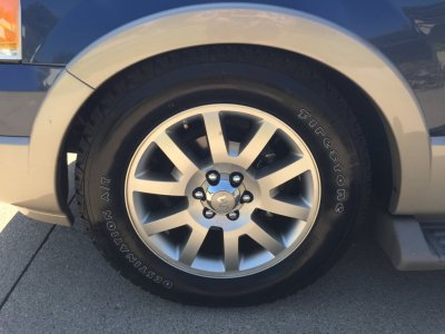

I have a 2006 Expedition with the factory 17" rims. I am needing new tires and am debating between new tires or new wheel/tire takeoffs online. In looking I have found that increasing the tires by < 1" in height should have no affect as far as rubbing but i want to make sure there arent any other concerns (tire pressure sensor, etc) by upgrading to newer factory rims. The bolt pattern hasnt changed, so i dont have concerns about the bigger wheels going on, just want to make sure i dont run into unforeseen issue. Any feedback/experiences would be appreciated.
I am looking to go from the current: 265/70R17 to the wheels/tires off of a newer Expedition: 275/55R20 (below). The actual height difference is only .3"

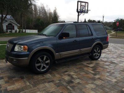

My 2003 EB 4X4 has all stock suspension and I replaced the original plain jane 17" with nice triple plated 20" wheels front & back.
I have 285/50/20 tires and there are zero issues with rubbing under any condition that I have encountered in over 10 years.
Sure makes the truck look a LOT better. The extra traction is very noticeable especially in the rain.

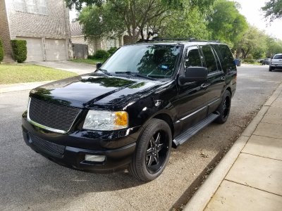

22" Foose wheels on my '03 which has been lowered with an Eibach kit. 285x45 Michelins, no rubbing anywhere and the ride is no different from when I ran 20"ers.
