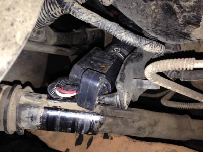

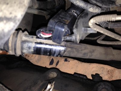

Any chance you could take a picture looking down at the top of the drivers side front ride height sensor from the engine bay?
My check suspension light came on, and when I looked at the top of the bracket/sensor from under the hood, I can see where my sensor mounting bracket has been bent upright and is now touching the steering column.
To top it off, my height sensor is now at a 90 degree angle (does not look right).
Anyway, I'd trying to get a reference point to see where the top sensor bracket/sensor sits in relation to the steering column so I can bend the bracket back into the proper position.
Any help would be appreciated.

Here are a couple of pics I took looking down at the top of the bracket/sensor from under the hood. You can see where the bracket/sensor has torn the bellows of the steering column and is now rubbing against the column.

Hey sorry just saw this. I can get some tomorrow for you.

Did you change anything around the wheel area ? Did you change anything at all.

Thanks reefkrazy, I can't wait to see the stock set-up so I can get this fixed. I did have the wheel off when I put in some sway bar bushings, but I don't remember moving the ride height sensor.
