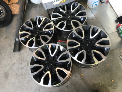

I recently picked up a set of 2014 Raptor wheels for my ride. Currently I have highway tires on factory wheels and have been trying to decide if I should wait until I can afford some new rubber before putting them on and keep the factory wheel/tire combo for a backup or just do a swap now. I have had the wheels for about 3 days and I am going crazy!! I can't wait to see them on my ride!

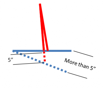

I'm curious about these struts. they only provide 1.25" of suspension lift, which is fine, you can still add spacers, body lift, whatever works.
what I'm curious about, though, is that this strut only has 5" of stroke. It's my understanding the 2nd Gen expy has 9" of suspension travel... so what's the point of lifting it with anything at all that effectively cripples the suspension?
what am I missing here?

Hey joethefordguy,
I believe the 5" of stroke on the strut translates to 9" of travel when you get out to the center of the wheel, so the travel stays the same. Thes struts give a bit of lift, so you can run a larger tire with less rub and they give you adjustability for your prefered firmness of ride.

I hear ya, but I don't buy it. that just does not make sense to me. if the bottom of the shock only moves a max of 5", the lower control arm can't move more than that relative to the upper.
Actually, the upper and lower control arms move in unison since they are tied to the knuckle. The shock extends up between the upper control arm but isn't connected to it. The shock comes down and ties into the lower control arm somewhere in the middle, and the chassis end is fixed, so if the center of the control arm moves 5 inches, you end up moving end of the control arm further.
Here's a crude sketch...
That's also why when you buy a 3" lift, the spacer that you add to the top of the coilover is actually less than that.
