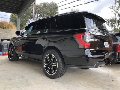

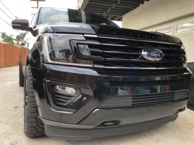

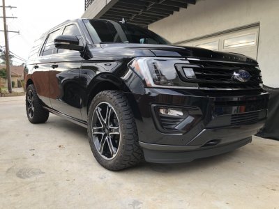

Just put 305 45 22’s on my stealth and just ordered the Traxda 2.75/2.25 kit.
They make a kit to handle the ERC, so will let you know how it goes and what kind of height I get out of it.
In the mean-time, Im loving how meaty it looks at stock height!

Looks great, even without a lift.

Any rubbing issues with that size tire at the stock height? I was thinking of going that route when I need new tires.
